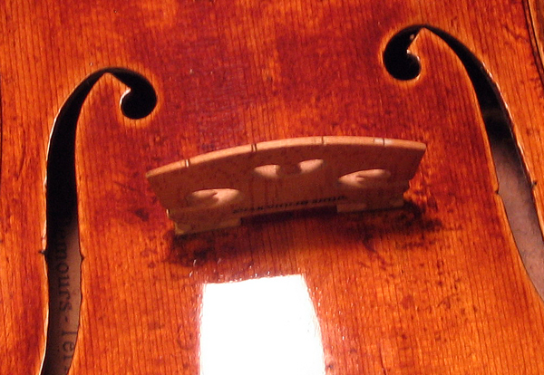

Though it doesn't have any numbers on it, here's what I generally do, more or less. If you go to the http://violinbridges.co.uk site you can see what good shops through time have done. Notice that there's a certain consistency to it, if you track the most famous ones.
As for what to do to change various things, the biggest problem I have in communicating that is the lack of a proper vocabulary--I listen to the violin, and from experience I sort of know where to go, but I couldn't always tell you why.

What this lovely picture fails to reveal is the fact that a bridge is a THREE dimensional object and that the third dimension is critical to how it functions.
Ther is an arch to the front and back of a bridge. This arch is crucial to the overall design. Maybe you can convince Michael to show a picture showing the arch (aka belly) of this bridge.

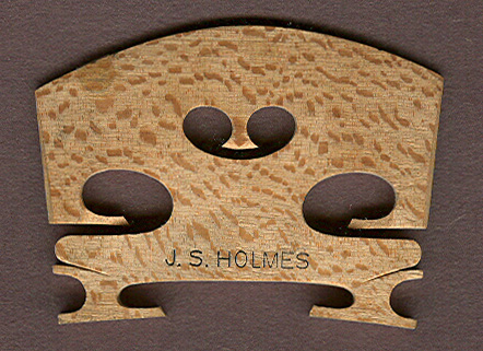

Hi Michael,
Do you always cut the protector patch with 135 degrees angles or sometimes you make it round like Jeffrey's ?

quote:
Yes, I always do mine that way--I cut mine from a sheet of skin; I suspect his are precut.

quote:
I used to do the same as Michael (I cut them from a drumskin), but I admit... if I'm not going to the trouble of an ivory inlay (rare), I really love the precuts... A small luxury. They are available in a few different thicknesses... but I like the thin ones for violin.
