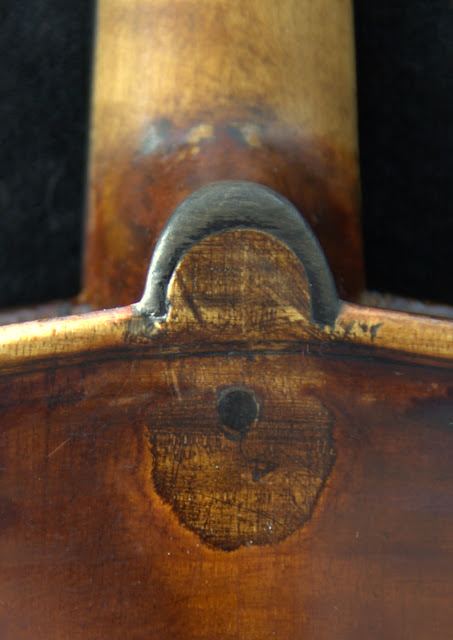

Hi Christian,
Kind of like this??? Some of the ebony has worn away.
Bruce
No, this seem to be the full edge with ebony? Lupot family?
François Lupot, Orleans, 1770.
I realise that the whole edge is that way but do you think the round French style ebony crown perhaps came from this???
