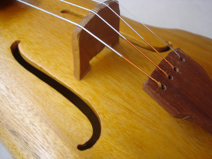

Don't think anyone has ever posted anything here about the rabeca - I'm uploading some photos of an instrument by Nelson dos Santos (Nelson da Rabeca) from the state of Alagoas in the north east of brazil. The rabeca is a Brazilian folk violin - it's meant to have its roots with the rebab - but that's a long story...
This rabeca is made from a wood called praíba - it's a softwood and very light. He tunes the lowest string between E flat to G (the open G on a violin) - and the other strings are tuned as a 5th, a 4th and a major 3rd - ie. a major triad. At the moment I have the instrument strung with viola strings and it sounds pretty nice. Nelson uses steel-string guitar strings or that of the cavaquinho (brazilian steel string ukulele) or the "viola caipira" - a brazilian guitar of portuguese origin.
The body, tailpin and the base of the neck are carved together from a single piece of wood with a cane knife and a plane. He then saws this "rabeca shaped obect" lengthwise from the side to form the top and bottom plates. These are hollowed out with a flat-edged pick and glued together. The neck, scroll and finger board are made from a second piece of wood and grafted to the neck stub on the body. The rabeca has a sound post but no bass bar.

It's nice to see these creative instruments every once in awhile.
No bass bar and very unique cycloids. :) [recent discussion Topics]
The sound is very different, but not unexpected. Make great music!

This instrument has a rare beauty about it.
Thanks for the pics
