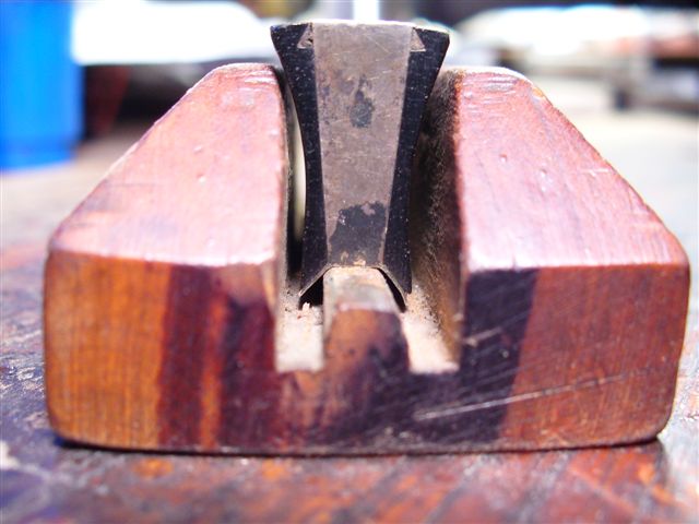

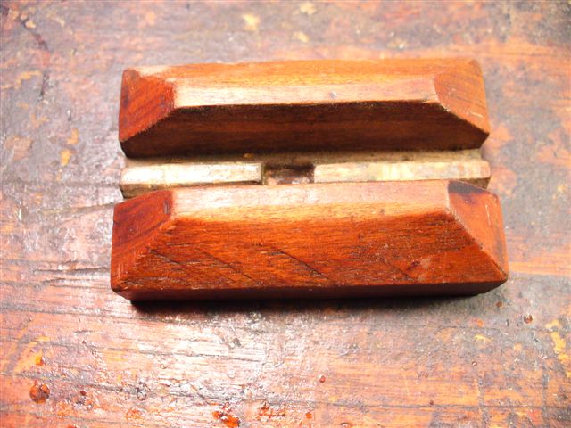

The problem with all the one-piece rehairing fixtures that I have ever seen is that they hold the bow by clamping the head and the frog. Clamping the head and the frog is potentially damaging. And it is totally unnecessary if the simple separate frog and head holding fixtures mentioned above are used. Here are some pictures of the ones that I made about 20 years ago and still use:
The sides hold the frog upright. The downward force of any work being done on the frog is supported by bottom center rail, protecting the delicate bottom edges of the frog. The center rail has a hole for the eyelet. This holder will take violin, viola and cello bow frogs. I made a bigger one for bass bow frogs.
